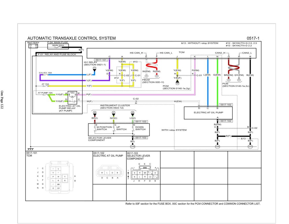

  2. What should I get if Openport does not work ?
  3. Hello everyone. I would like to read/write Mazda skyactiv TCM with PCMFlash Module 80 via Openport 2.0 , Anyone have experience ? 1. If I connect power( PIN A+ C+ B-) and HS CAN (PIN E , F) to TCM Module connector directly , Can it be read/write via CAN port ? 2. Need to get PowerBox for PCMFlash , connect power( PIN A+ C+ B-) and HS CAN (PIN E , F) to TCM Module connector directly , Can it be read/write via CAN port ? 3. Need to get PowerBox for PCMFlash with BDM Mode(connect to chip) ? 4. Other better/easier way ? Thanks for your reply .
